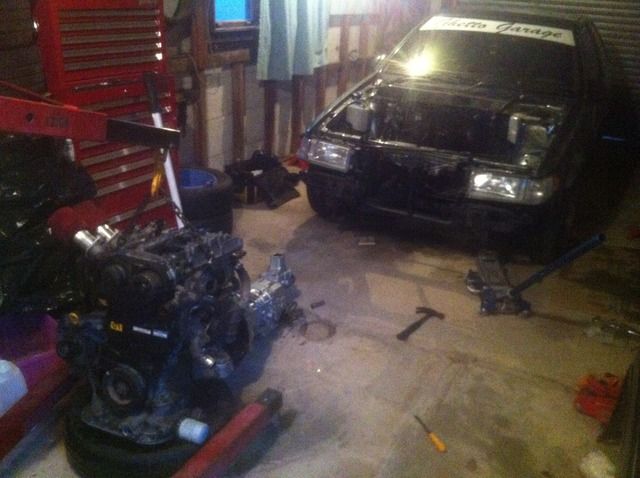

when the car was on the hoist i noticed my efforts to stop an oil leak were not very well executed
in fact i had made it worse.....
so engine out as that seemed like an easier option to make sure everything is 100%
Tim.duncan
Active Member
Nov 11, 2008
1,780
36
Snowy mountains
100% rear main
people at repco couldn't find beams info so i got a 3sgte rear main thinking it would be the same ... i was clearly wrong
crank looks fine which is a bonus
