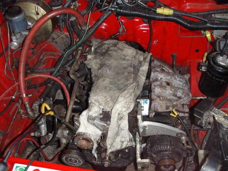

bought it a few weeks ago was goin mad till it started to miss. checked it all out and it good leaking valves so the head is away getting overhauled now.
it has a AFM GZE out of a AE92, VT como Brakes with slotted rotor, open S series( T18 is on the way) big front mount. plans are for t28 roller and haltech. not to much boost though cause i want it to last. full suspension set up. gunna use it as daily driver, bit of drift and the odd supersprint.

i got the head back and it's back on. just have to put the rest of the stuff back on. i fitted it with a cometic matel head gasket and a ARP STUD kit to replace the toyota 10 head bolts.
just a couple of pics of the front mount. so stealth.

pics of the reco'd head
will be running in a few days just waiting on the rest of the VRS kit.
the torque on the head studs is 20nm- 60nm -82nm if you wanted to know.

it's running again. the net is down at home so i can't post any pics. just need to change the oil and flush the coolant and it all finished.
