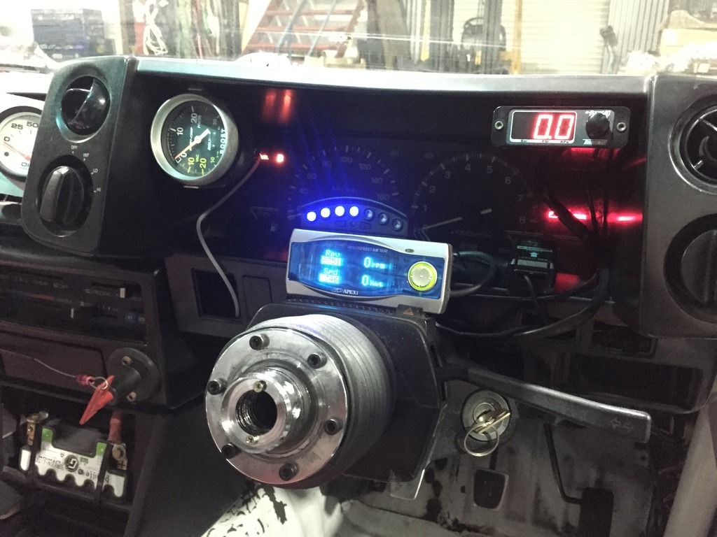

Soo.. I had a fairly well productive weekend just now..
Got my shift lights wired in
RSM wired in and all setup with G-Force sensor
Eboost Street 40psi wired in and mostly setup just waiting on dyno time to finalise boost levels and ramps..
Pic and vid.. Revs in 5th while on jack stands lol.. Can rev harder than that but rev limit is turned down as it over revs a lot when mucking around free revving etc..
I'm pretty happy with my poor mans race dash.. It's going to be awesome to drive it now with all the meters and stuff.. Not to mention the maximum value recal function on the RSM and all the 0-100 and 400m timing etc it can do, be interesting to see how accurate it is !
